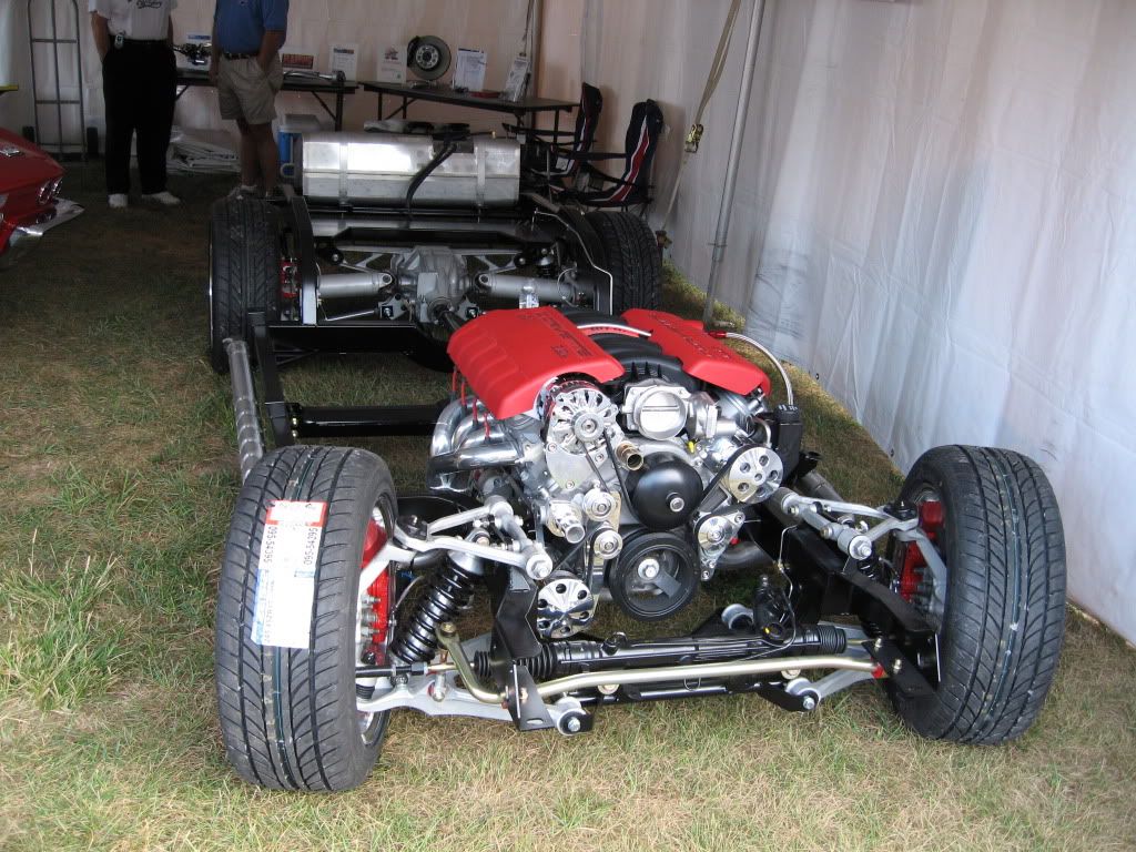

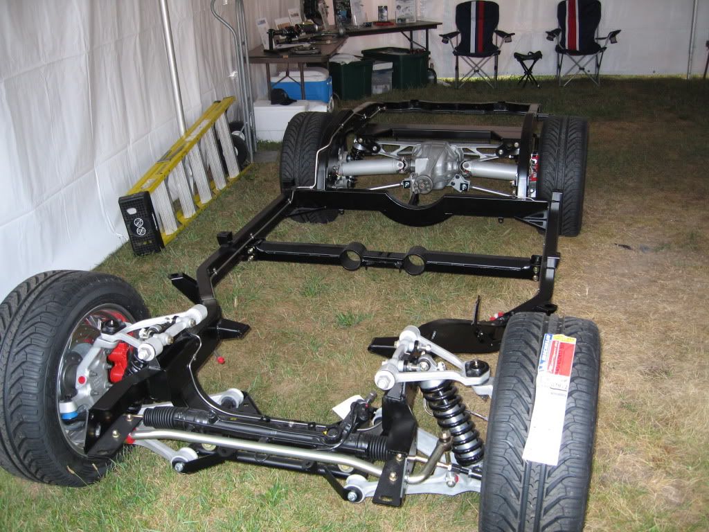

wabco40
I have the same set up as 72vet. I purchased it about 6 years ago and even back then it was a proven product. However I am still yet to drive the car with this set up.
If I had found I had a rusted or damaged chassis when I started the rebuild then I would have purchased a Street Shop Inc C3 chassis.
I have spoken to their rep and seen the quality of their chassis. They available from bare frame to complete rollers with your choice of engine/tranny mounts.
There not cheap, the prices several years ago where 9 to 15 grand. With the dollar the way it is at the moment the prices are not to bad.
[IMG=700x525]http://i1233.photobucket.com/albums/ff391/wabco40/IMG_0185.jpg[/IMG]
[IMG=700x525]http://i1233.photobucket.com/albums/ff391/wabco40/IMG_0187.jpg[/IMG]

wabco40   those photos look extraordinarily tidy
I have been trying to contact Streetshop  my email  missed them on a phone call today will try earlier tomorrow .
I do like the look of there chassis .
wabco40
The mod to your chassis looks excellent

I have just realized that the photos are of a street shop
chassis
Still very tidy
I could live with  something like that under  one of my corvettes
