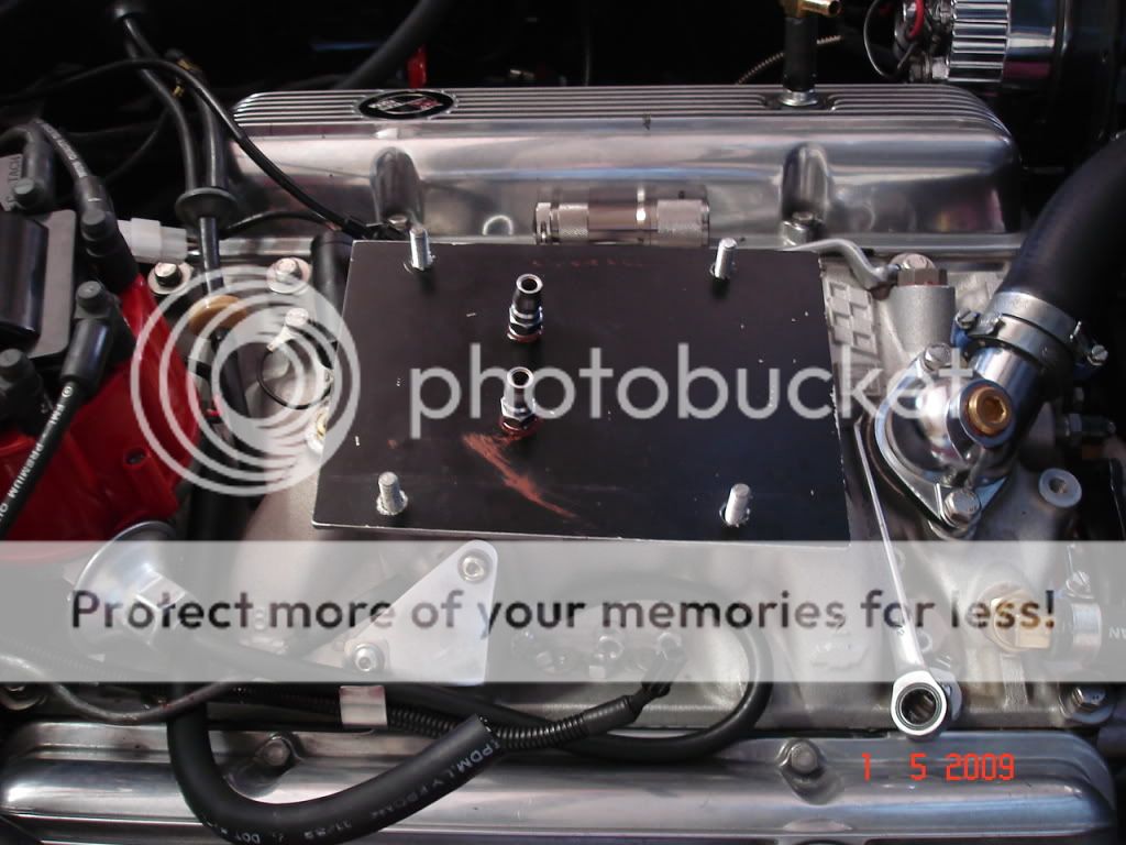

Hi 87Z51, Thanks for your input. The leakage from one side of the air plenum to the other is major, like no restriction at all. I have plugged the EGR holes in the plenum, so that can't be the cause. Below is a shot of my most recent, and rather unconventional test setup. I pumped 10lb air into one side, thinking it should just pressurise unless there is a leak of some sort. All rockers were loosened, so all valves closed. The air just came straight out the other side, hence my thought that it's the lack of divider in the inlet gasket. There was plenty of silastic on the plenum divider so it shouldn't have just been leaking under the test plate. Only other thing I can think of is a casting fault in the manifold, but that's unlikely. Think I'll ask some questions about why GM made them like this in the first place. This is my first foray into Vortec, I'm starting to wonder why I did it now. Still have a problem with only 8 small bolts to hold down the inlet manifold.

87Z51
QuoteOriginally posted by Reklaw
 The leakage from one side of the air plenum to the other is major, like no restriction at all. ... The air just came straight out the other side, hence my thought that it's the lack of divider in the inlet gasket.
So it leaks from one side to the other , but both sides should have the same fuel content so that doesn't account for the lean cond .
