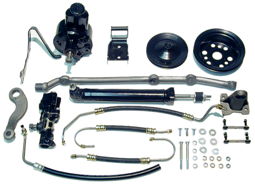

and here's a power steering kit
http://www.cssbinc.com/images/PowerSteering/PSC-SB-PS-conv-kit.jpg
common sense tells me the ball joint needs to be in the same position whether power or manual
